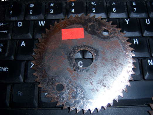

PostPosted: Fri Aug 17, 2007 2:46 pm
Remember this thread??
I happened to get a chance to get out tonight and went by the local flea market. I always look for stuff there because I can buy some specialty tools at good prices in some of the stalls.
anyway, even though I have ordered 3 different thin kerf blades for the band saw for sawing up laminated veneers into thin strips, I still am thinking about it. I found these blades today:
I dont know if you can read the price on them, but it is $2.98
I bought a couple even though they have a little surface rust on them. They are brand new and sharp though. I measured the thickness of the blades at .021 but because of the set in the blade they cut at .042. Too wide for cutting fret slots, but just right for cutting the laminated B/W/B veneers I am making. They are 3 5/8" in diameter and have a standard 5/8" arbor hole. Now I just need to think of how I can mount these things in order to use them
I still dont know if they will work, but at that price, I cant go wrong!
I have no clue what they are actually meant to be used for, but I know what I am going to try
